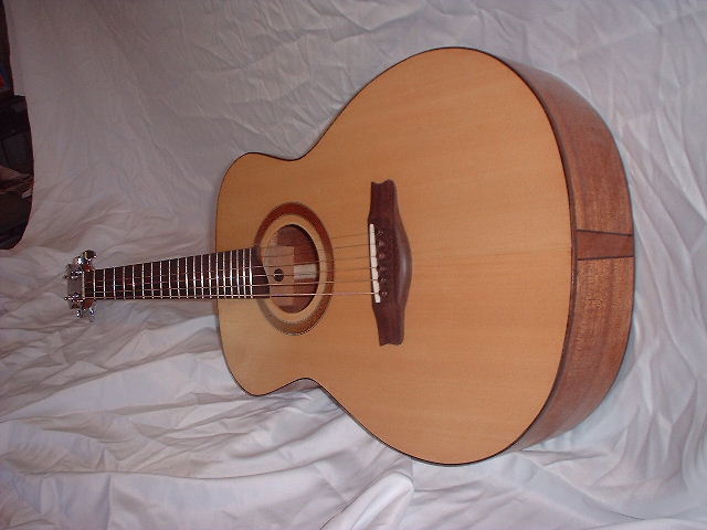

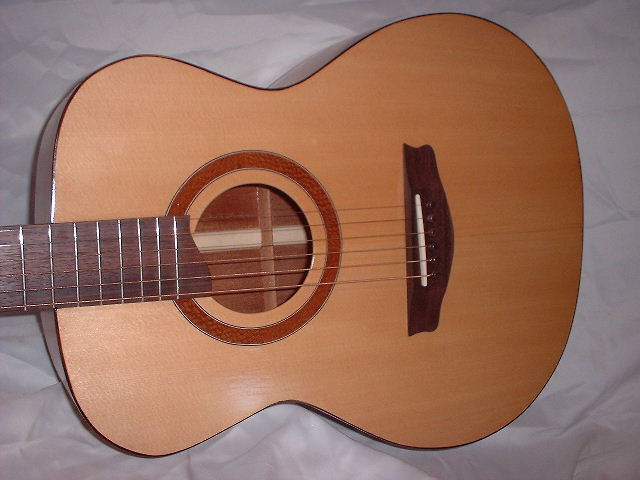

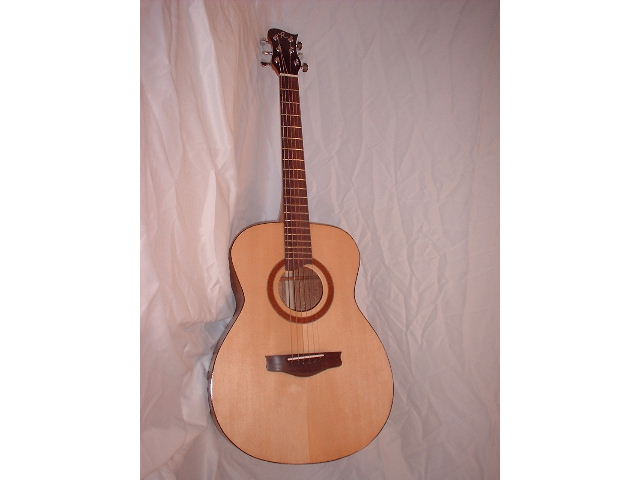

This is it!My first! A LMI unserviced kit with added lace wood rosette and rosewood binding and endgraft. I recieved the box of material Feb 11 and strung it up today. Cannot believe the innotation is right on. I'm a fanatic about guitars in tune. I sure left alot of room for improvement esthetic wise though. My binding is thinner in some areas,my finish,well, let's just say you can't see it in these pictures. I was wondering about the size of my bridge. Too big? I really didn't stick to any one plan,the LMI kit was supposed to be a dred, but I don't have an OM. It weighs in at 4 lb. and 4 oz. I want to thank the OLF for all the support and advice. Finding this website was a blessing. On to number two ??...Clinton

Beautiful
What a start!!!!

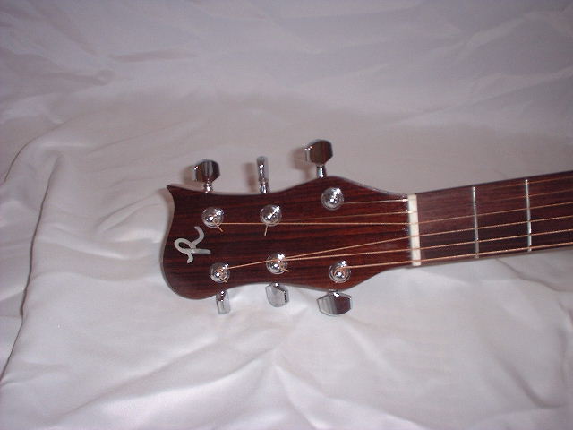

I love your headstock shape.
We need more close up picts.!!!!
Personally I think your bridge is fine

Congrats on your 1st Clinton, It looks a lot better than my 1st.I think it looks great,The bridge is fine and the rosette is great ,I like it all!

Hey, that's pretty cool, Clinton! I like the fact that you put your own creative thinking into the kit. The bridge does look a little hefty, though. There've been a couple of threads recently that mention appropriate weight ranges for bridges. I'd suggest getting a scale and weighing the parts on your next build; although, at 4lbs, 4oz., it sounds like you're doing something right!

Carving down the bridge somewhat could be one way of bringing out the high end more. You could still do that. OTOH, it might get better on its own. It might also sound better with different strings. And, it might also sound quite a bit different from out in front than from the player's perspective.
All that said, the unique character of its sound will probably grow on you. I think we often tend to sell an instrument short if we get stuck in our preconceived ideas of what it should sound like. Whatever its unique voice, no doubt this is the PERFECT guitar for a whole range of musical expression. Let it speak to you and lead you where it wants to go.

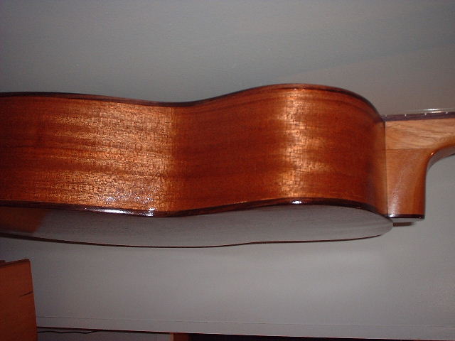

Clinton, more pics please, she's too beautiful, how about the back and the sides?

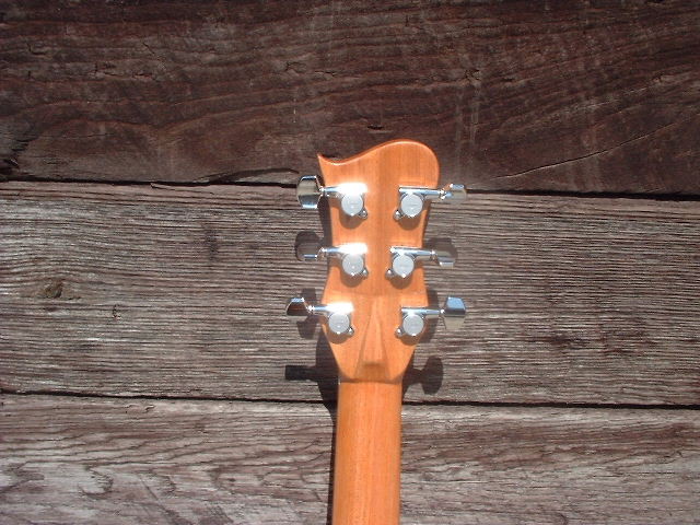

Ok, here is a couple of more pics. I did the neck and headstock with diluted shelac and the body was started with Minwax brush on lacquer. Don't believe the can, I got better results from the areosol spray lacquer. I will try buffing in a couple of weeks and see if that helps. The sound is pretty good, so maybe it will be my campfire guitar. Clinton

Love that headstock and volute Clinton, your back and sides are looking neat! Great job! Thanks for the added pics!
